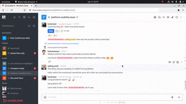

Rocket.Chat can be easily extended with powerful Apps.
Here is a step by step of how I created MemeBuddy for Rocket.Chat.
MemeBuddy in action on Rocket.Chat

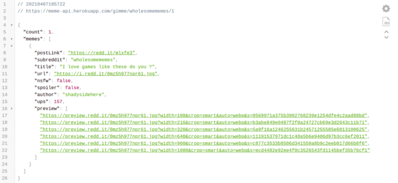

Calling APIs of external systems — Gimme the Memes
Apps in Rocket.Chat often reach out to large external systems to get data or have work done. Apps call out on RESTful APIs. MemeBuddy calls D3vd’s Meme API for fetching memes.
In MemeBuddy, we use http.get() and supply REST arguments subreddit and number of memes to a hosted server at:
https://meme-api.herokuapp.com/gimme/wholesomememes/1
The result is:
JSON response from the Meme API

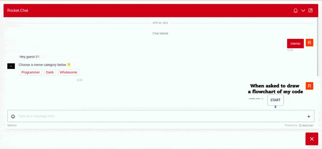

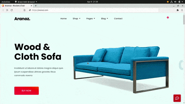

Adapting App for LiveChat — Omnichannel Operation
Rocket.Chat is also a great platform for building real-time omnichannel customer service websites and community engagement portals. Its LiveChat widget is used by millions of users on a daily basis.
LiveChat customer service bot in action
Adapting MemeBuddy to work with the LiveChat widget is straightforward.
There is no slash command in LiveChat, but recognition of “trigger words” in messages can take its place.
Parsing trigger words in LiveChat messages
To access every message sent, make the MemeBuddyApp class implement IPostMessageSent interface and hook executePostMessageSent(). Here, I check for the trigger word :meme:
if (message.room.type !== “l”) {
 return;
if (message.text === “:meme:”) {
const data = {
room: message.room,
sender: message.sender,
await initiatorMessage({ data, read, persistence, modify, http });
} // end of if block
} // end of function block
Interactive button clicks within LiveChat messages are handled through the executeLiveChatBlockActionHandler() method. The differences when sending messages to LiveChat are:
  1. 1. Use of startLiveChatMessage instead of startMessage.
  2. 2. Setting the visitor for sending the message within LiveChat.
  3. 3. Notifiers are not applicable for LiveChat messages.
Now MemeBuddy works on both the team chat and the omnichannel LiveChat widget!
Calling MemeBuddy within LiveChat
