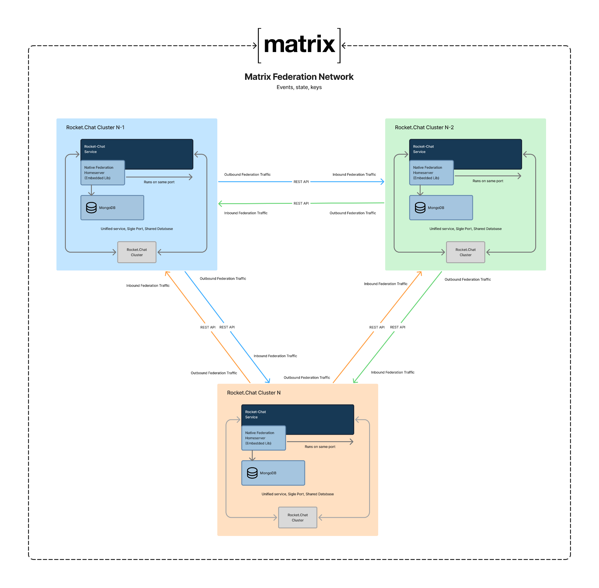

The shift we made was architectural. Instead of running Matrix as a parallel stack alongside Rocket.Chat, we implemented the protocol as a library that runs inside Rocket.Chat as a single process. No second backend. No second database. No conversion layer between data models. The federation engine is part of the server, not bolted to it.
“Matrix is the federation protocol of Rocket.Chat. Rocket.Chat and the federation engine run together as a single process. No extra dependencies, no extra deployment, no second backend in the middle. We built it as a library so it stays modular, but from the operator’s point of view, it is just Rocket.Chat.”

What that looks like in deployment: three things sitting on top of each other inside one process. The Rocket.Chat service, the native federation engine running as an embedded library, and MongoDB as the shared database. The federation engine runs on the same port as the rest of Rocket.Chat. Federation traffic between two Rocket.Chat clusters moves over REST APIs that speak the Matrix protocol.
Rocket.Chat native federation across three clusters. The federation homeserver runs as an embedded library inside each Rocket.Chat process, against the same MongoDB. Server-to-server traffic flows over the Matrix protocol.
